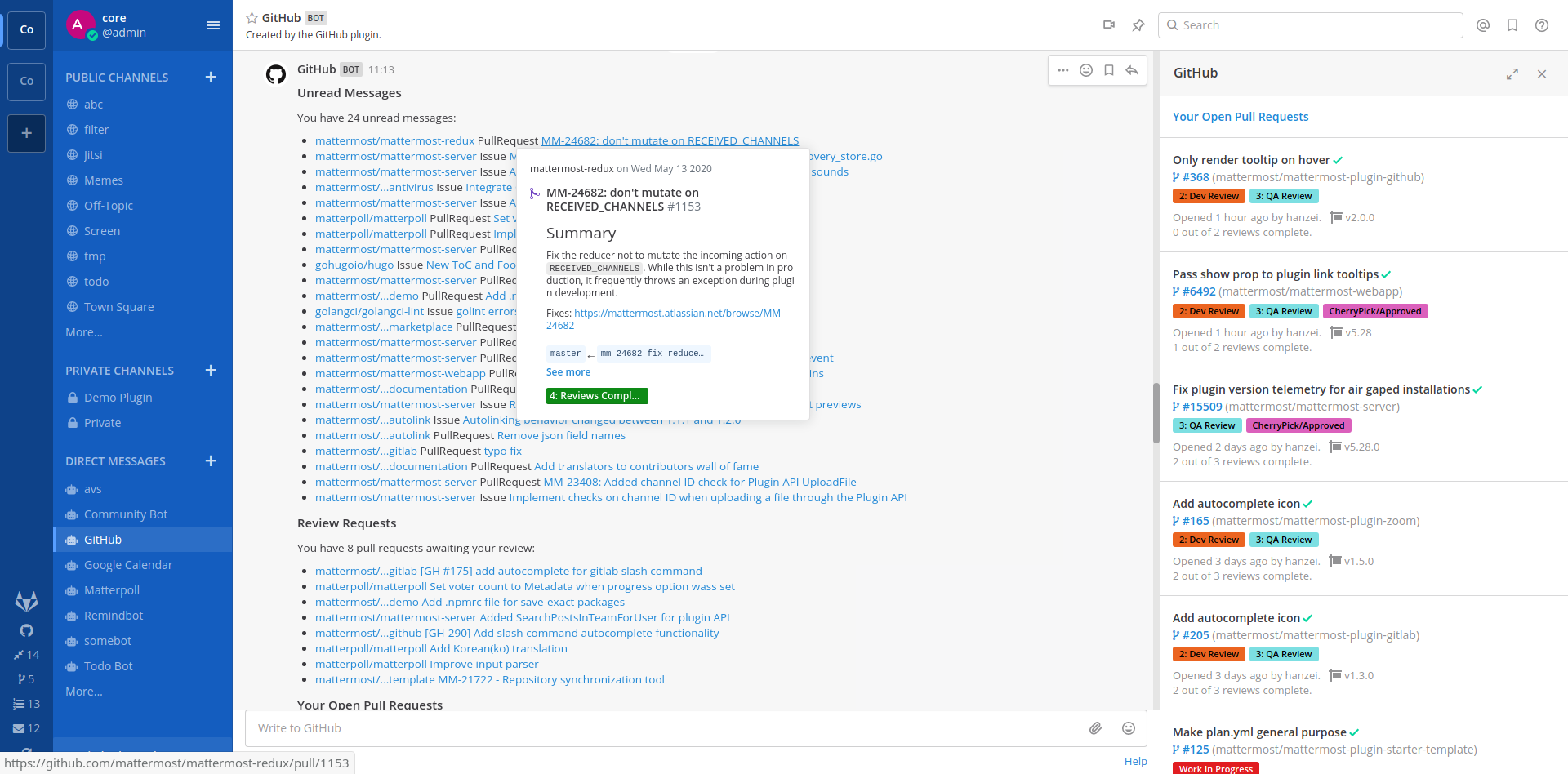

An example of the GitHub integration for Mattermost.

Once connected, you'll receive direct messages from the GitHub bot in Mattermost when someone mentions you, requests a review, comments on, modifies one of your pull requests/issues (includes adding labels or reopening the issue), or assigns you to an issue on GitHub.
