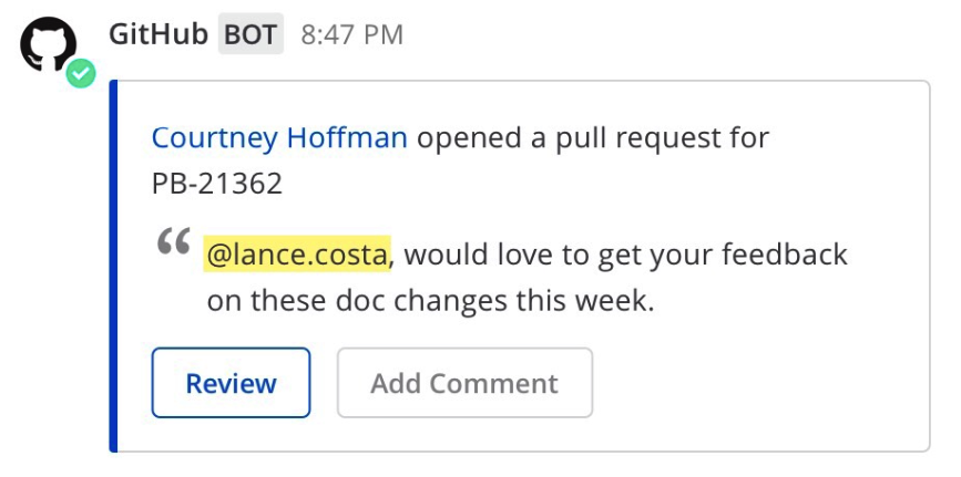

Interactive messages
For information on interactive dialogs, see here.
Use interactive messages to simplify complex workflows by allowing users to take quick actions directly through your integration post. For example, they enable your integration to:
  • Mark a task complete in your project management tracker.
  • Conduct a customer survey or a poll.
  • Initiate a command to merge a branch into a release.

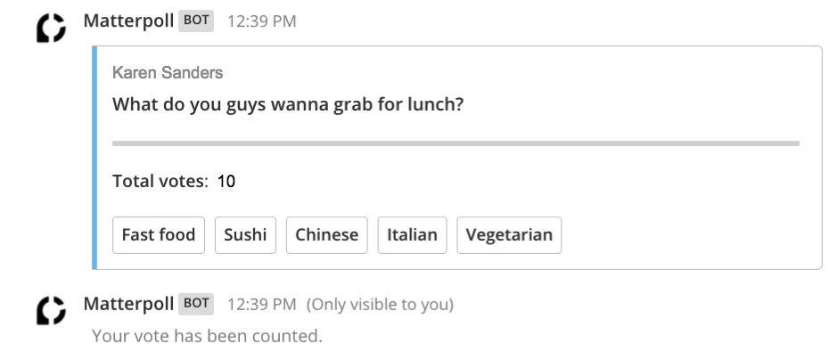

To try it out, you can use this Matterpoll plugin to add polling to Mattermost channels via a /poll slash command.
Mattermost Blocks are the recommended way to build interactive integration posts. Send a block tree in props.mm_blocks for layout, text, images, buttons, and menus, and register action handlers in props.mm_blocks_actions.
See Mattermost Blocks for the full block schema, action types, validation limits, and examples.

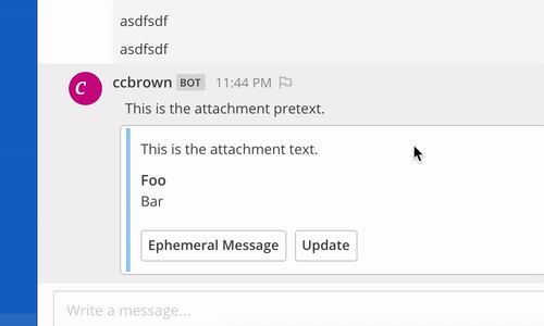

Message buttons​
Add message buttons as actions in your integration message attachments.
The following payload gives an example that uses message buttons.
"attachments": [
"pretext": "This is the attachment pretext.",
"text": "This is the attachment text.",
"actions": [
"id": "message",
"name": "Ephemeral Message",
"tooltip": "Send a message only visible to you",
"integration": {
"url": "http://127.0.0.1:7357",
"context": {
"action": "do_something_ephemeral"
"id": "update",
"name": "Update",
"tooltip": "Update this message",
"integration": {
"context": {
"action": "do_something_update"
In the HTTP response for this request, the integration can choose to update the original post, and/or respond with an ephemeral message:
"update": {
"message": "Updated!",
"props": {}
"ephemeral_text": "You updated the post!"
To return a custom error message to the user, your integration can respond with an error object:
"error": {
"message": "Unable to complete action. Please check your permissions."
The error message will be displayed to the user below the interactive content. If no custom error message is provided, a default "Action failed to execute" message is shown. This feature is available in Mattermost v10.5 and later.

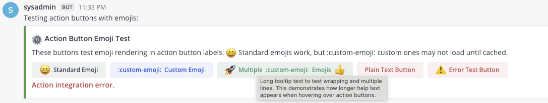

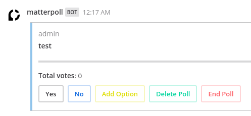

Button actions support a style parameter to change the color of the button. The possible values for style are: good, warning, danger, default, primary, and success. It's also possible to pass a theme variable or a hex color, but we discourage this approach because it won't be resilient against theme changes.
The actions used in the previous example include the following:
"id": "vote0",
"type": "button",
"name": "Yes",
"style": "default"
"id": "vote1",
"type": "button",
"name": "No",
"style": "primary"
"id": "addOption",
"type": "button",
"name": "Add Option",
"style": "warning"
"id": "deletePoll",
"type": "button",
"name": "Delete Poll",
"style": "success"
"id": "endPoll",
"type": "button",
"name": "End Poll",
"style": "danger"

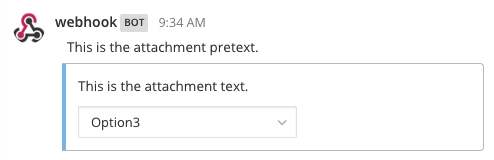

Message menus​
Similar to buttons, add message menus as actions in your integration message attachments.
The following payload gives an example that uses message menus (where id in the actions array may only consist of letters and numbers, no other characters are allowed):
"attachments": [
"actions": [
"id": "actionoptions",
"name": "Select an option...",
"integration": {
"url": "http://127.0.0.1:7357/actionoptions",
"context": {
"action": "do_something"
"type": "select",
"options": [
"text": "Option1",
"value": "opt1"
"text": "Option2",
"value": "opt2"
"text": "Option3",
"value": "opt3"
The integration can respond with an update to the original post, or with an ephemeral message:
"update": {
"props": {}
