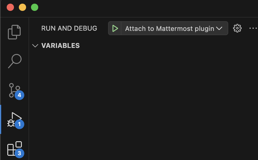

Attach the debugger to the delve process

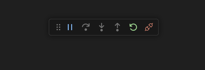

Run the debugger in VSCode by navigating to the "Run and Debug" tab on the left side of the IDE, selecting your launch configuration, and clicking the green play button. This should bring up a debugging widget that looks like this:
Your IDE's debugger is now running and ready to pause your plugin's execution at any breakpoints you set in the IDE.

If you run into issues with debugging, first make sure you've stopped any active debugging sessions by clicking the red disconnect button in the VSCode debugging widget.
