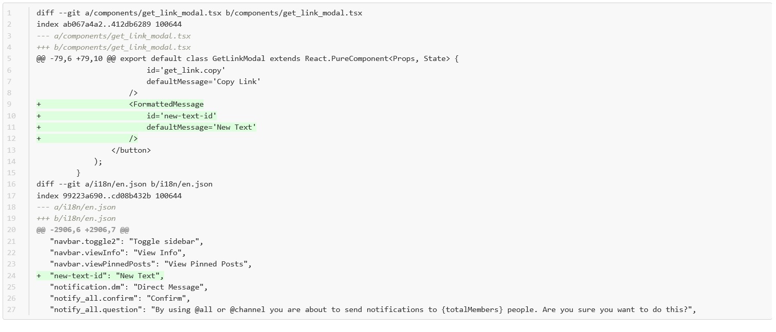

  2. Run git diff and determine if your strings were added or removed in the i18n/en.json file correctly. If this was a successful extraction you will have output similar to below:

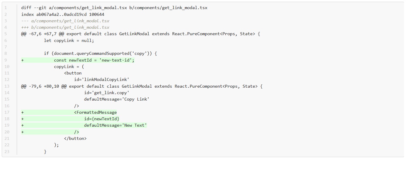

  3. However, if you have a string that was not properly extracted you will see an output similar to below. If you executed the make i18n-extract at this point nothing would change because the string "new-text-id" is not detected as a string that needs to be translated.

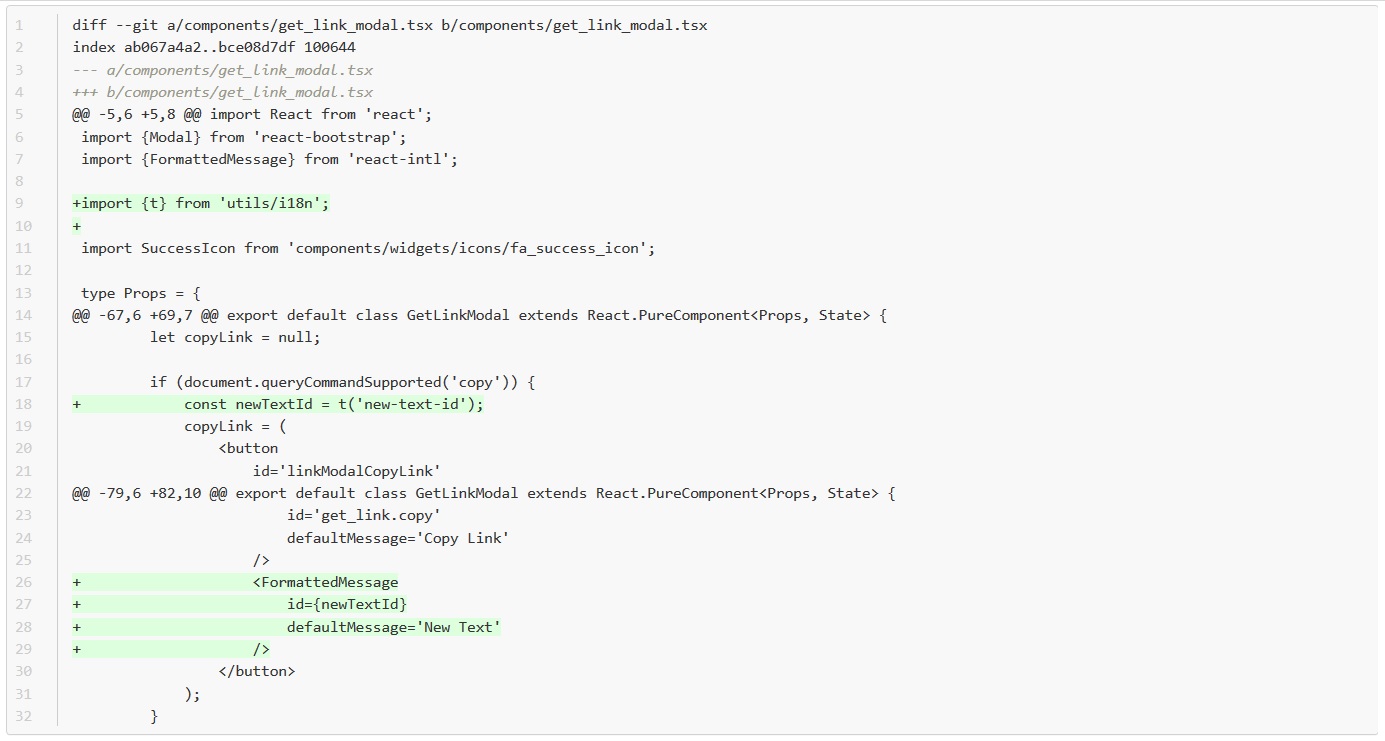

  4. The solution is to tag the string. Do this by using the "t" function, shown in the example below:

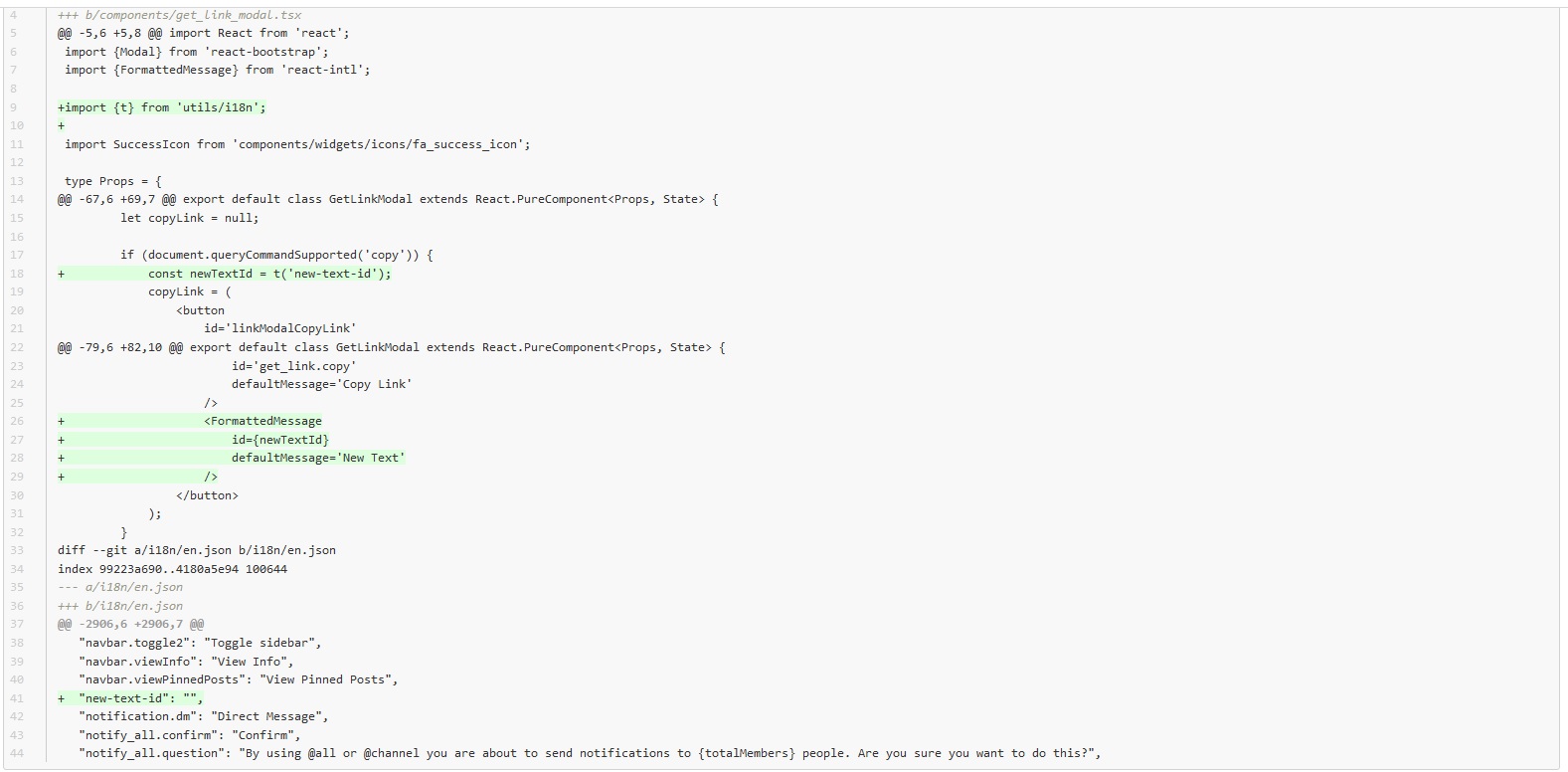

  5. At this point you will need to execute the make i18n-extract once again and determine if the extraction was successful. This will generate a message in the i18n/en.json file. However, this is not going to extract the "default message", you will have to add this yourself. See example below:
