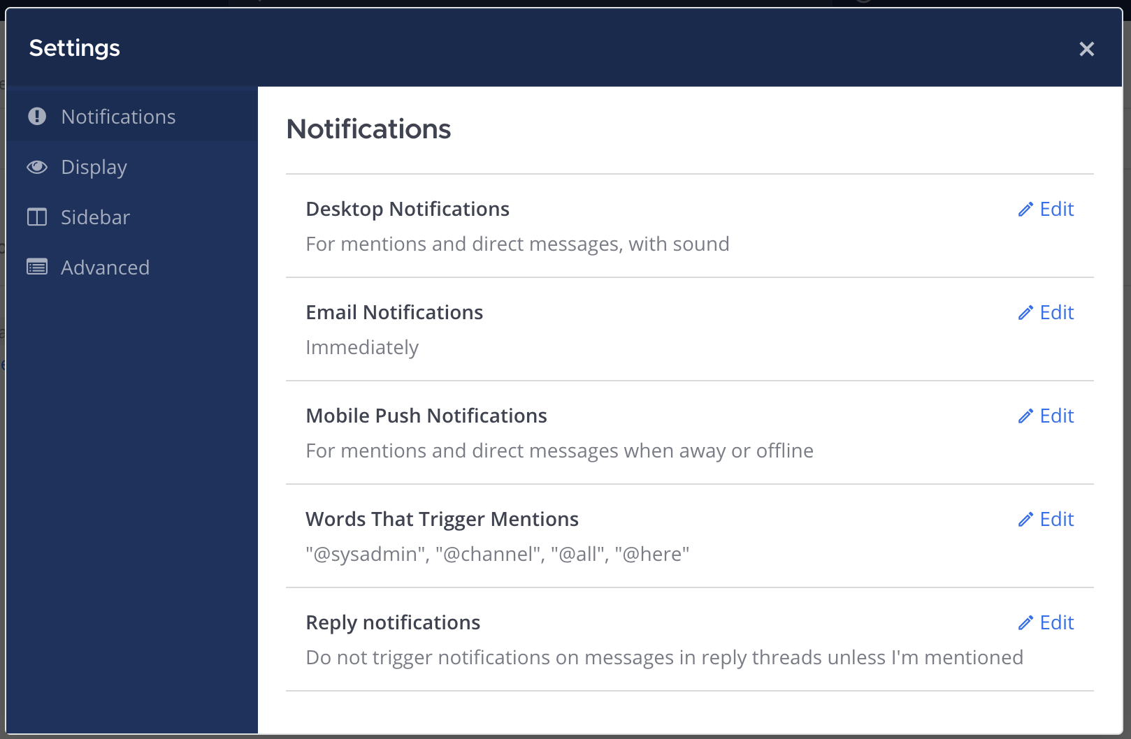

Settings Modal​
settings modal image
Opening the settings modal​
The function cy.uiOpenSettingsModal(section) opens the settings modal when viewing a channel. section is of the < string > type. Possible values for section are: 'Notifications', 'Display', 'Sidebar', and 'Advanced'.
  • Open 'Settings' modal and view the default 'General Settings': cy.uiOpenSettingsModal();
  • Open the Settings modal and view a specific section (like the 'Advanced' section): cy.uiOpenSettingsModal('Advanced');
  • Open the Settings modal, view a specific section, and change a setting:
    // # Open 'Advanced' section of 'Settings' modal
    cy.uiOpenSettingsModal('Advanced').within(() => {
    // # Open 'Enable Join/Leave Messages' and turn it off
    cy.findByRole('heading', {name: 'Enable Join/Leave Messages'}).click();
    cy.findByRole('radio', {name: 'Off'}).click();
    // # Save and close the modal
    cy.uiSave();
    cy.uiClose();
Selecting a section's button within a modal​
Use the function cy.findByRoleExtended('button', {name}). name is of the < string > type. Possible values for name are: 'Notifications', 'Display', 'Sidebar', and 'Advanced'.
  • Clicking a button within the Settings modal:
    cy.uiOpenSettingsModal().within(() => {
    // # Click 'Notifications' button
    cy.findByRoleExtended('button', {name: 'Notifications'}).should('be.visible').click();
Select a section's setting within a modal via the name of the section​
Use the function cy.findByRole('heading', {name}). name is of the < string > type. Possible values for name are: 'Full Name', 'Username', and others depending on the sections in the modal.
  • Open a section within the Settings modal:
    // # Open 'Notifications' of 'Settings' modal
    cy.uiOpenSettingsModal('Notifications').within(() => {
    // # Open 'Words That Trigger Mentions' setting
    cy.findByRole('heading', {name: 'Words That Trigger Mentions'}).should('be.visible').click();
Select a section's setting within a modal via role​
Use the function cy.findByRole(role, {name}). role is of the < string > type. Possible values for role are: 'textbox', 'radio', 'checkbox' and other roles. name is of the < string > type. Possible values for name are: 'On', 'Off', and others depending on a section's settings.
  • Change value of a section's setting in the Settings modal:
    // # Check channel-wide mentions
    cy.findByRole('checkbox', {name: 'Channel-wide mentions "@channel", "@all", "@here"'}).click();
Saving and closing a modal​
cy.uiSave and cy.uiClose are common functions that can be used to save things and close modals.
  • Saving and closing in the Settings modal:
    // # Save then close the modal
    cy.uiSave();
    cy.uiClose();

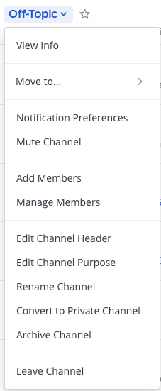

Channel Menu​
channel menu image
Opening the channel menu​
Use the function cy.uiOpenChannelMenu(item). This will open the channel menu by clicking the channel header title or dropdown icon when viewing a channel. item is of the type < string >. Possible values for item are: 'View Info', 'Move to...','Notification Preferences', 'Mute Channel', 'Add Members', 'Manage Members','Edit Channel Header', 'Edit Channel Purpose', 'Rename Channel', and 'Convert to Private Channel', 'Archive Channel', and 'Leave Channel'.
  • Open the channel menu normally:
    // # Open 'Channel Menu'
    cy.uiOpenChannelMenu();
  • Open the channel menu and click on a specific item:
    cy.uiOpenChannelMenu('View Info');
Closing the channel menu​
Use the function cy.uiCloseChannelMenu(). This will close the channel menu by clicking the channel header title or dropdown icon again at the center channel view, given that the menu is already open.
Get the DOM elements of the channel menu​
Use the function cy.uiGetChannelMenu().
