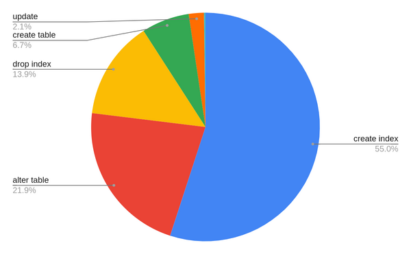

A rough analysis of our past schema migrations shows the following (some very early migrations were skipped which would be considered as base Mattermost):
CREATE INDEX - 489
ALTER TABLE - 195
ADD COLUMN - 113
ALTER COLUMN - 51
DROP COLUMN - 25
ADD CONSTRAINT - 6
DROP INDEX - 124
CREATE TABLE - 60
UPDATE - 19
DELETE - 2
Migrations distribution
We will go through each of these migration types and discuss how we can make it non-blocking. This is a lengthy document, so for those wanting to directly look at the executive summary, we present it right now. And then expand on each section in detail later.

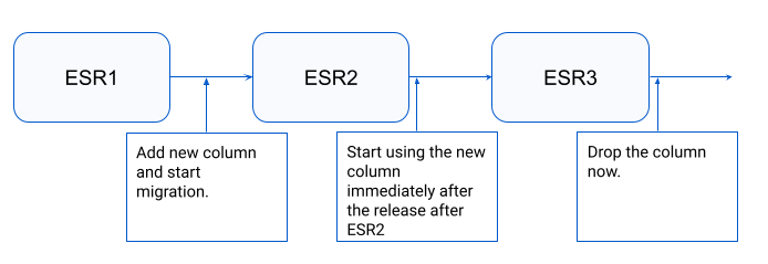

How do I change a column type if I MUST​
Follow this long-winded procedure:
  • Create a new column.
  • Migrate existing data.
  • From next ESR, start using the new column.
  • Next ESR, drop the old column.
For example, let’s say the next upcoming version is 8.4, and the next ESR is 8.6. So step 1 and 2, goes in 8.4. And in 8.7 onwards, we add the code to start using the new column, which will eventually be part of 8.12 (ESR after that). And then from 8.13 onwards, we can drop the column.
The following diagram should explain things better:
ESR migrations
The reasoning behind this is some customers will only upgrade from ESR to ESR. So we need to ensure backwards compatibility with the previous version.
