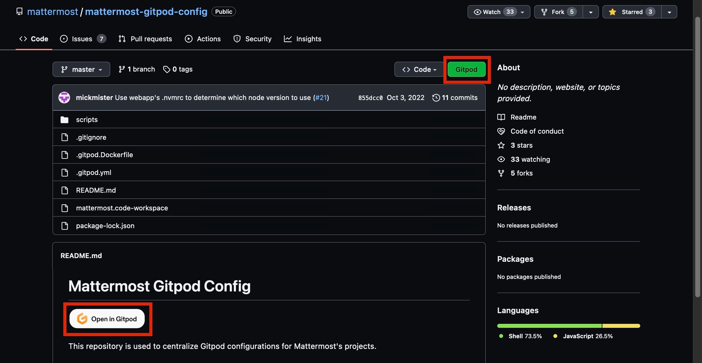

  1. Create a new workspace for a ticket/issue that you've claimed by going to the mattermost-gitpod-config repository and clicking the "Open in Gitpod" badge.
    • You can also use the Gitpod browser extension to open up a repository in Gitpod, or manually prefix GitHub repository URLs with gitpod.io/#. What the extension does is add a green Gitpod button to repository pages on GitHub, and clicking it spins up a new environment for the repository on Gitpod. mattermost-gitpod-config-repo

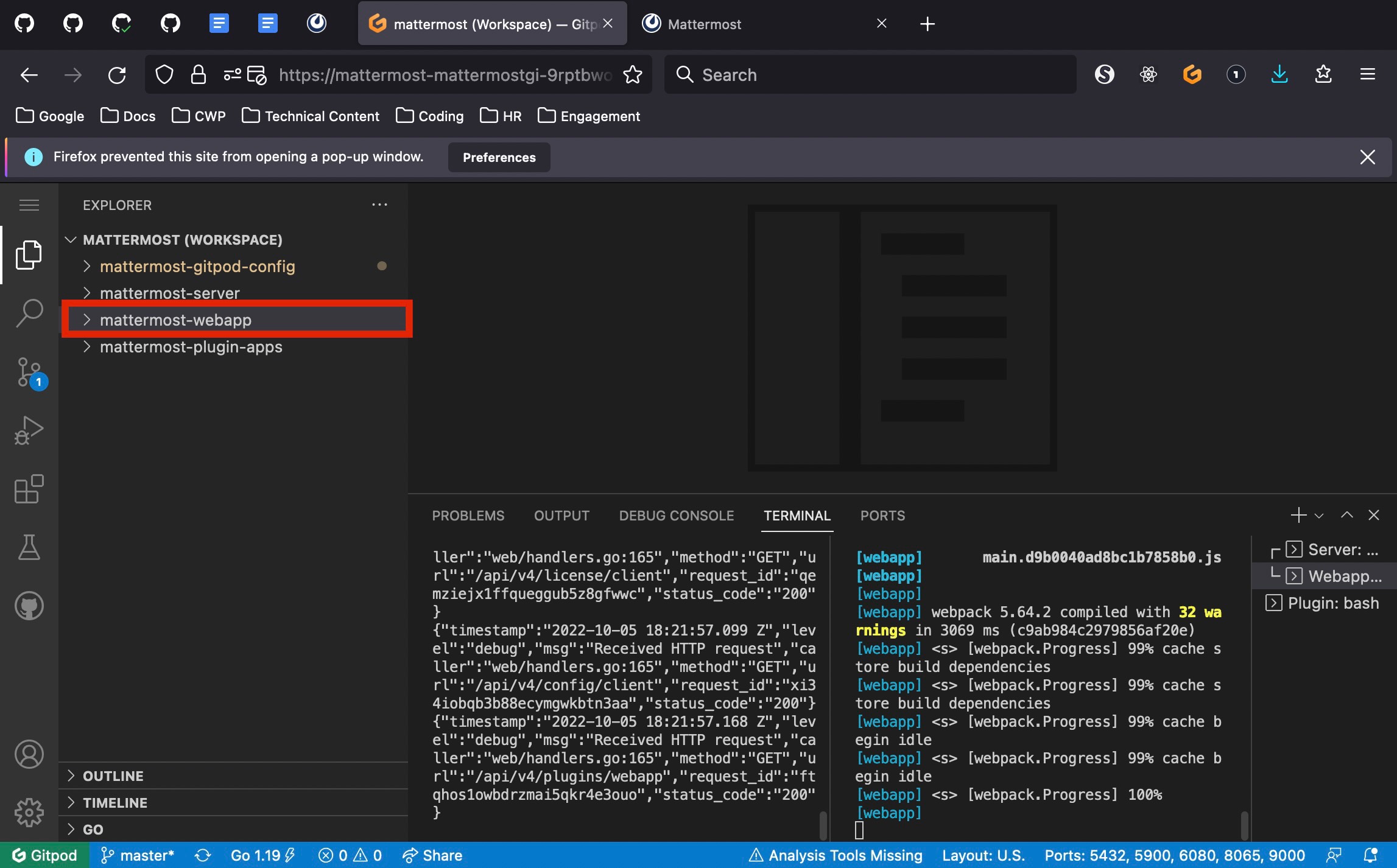

  2. You may need to sign in (through GitHub) to access the workspace on Gitpod. Once Gitpod has done loading, the user interface presented is that of VSCode. mattermost-gitpod-intro

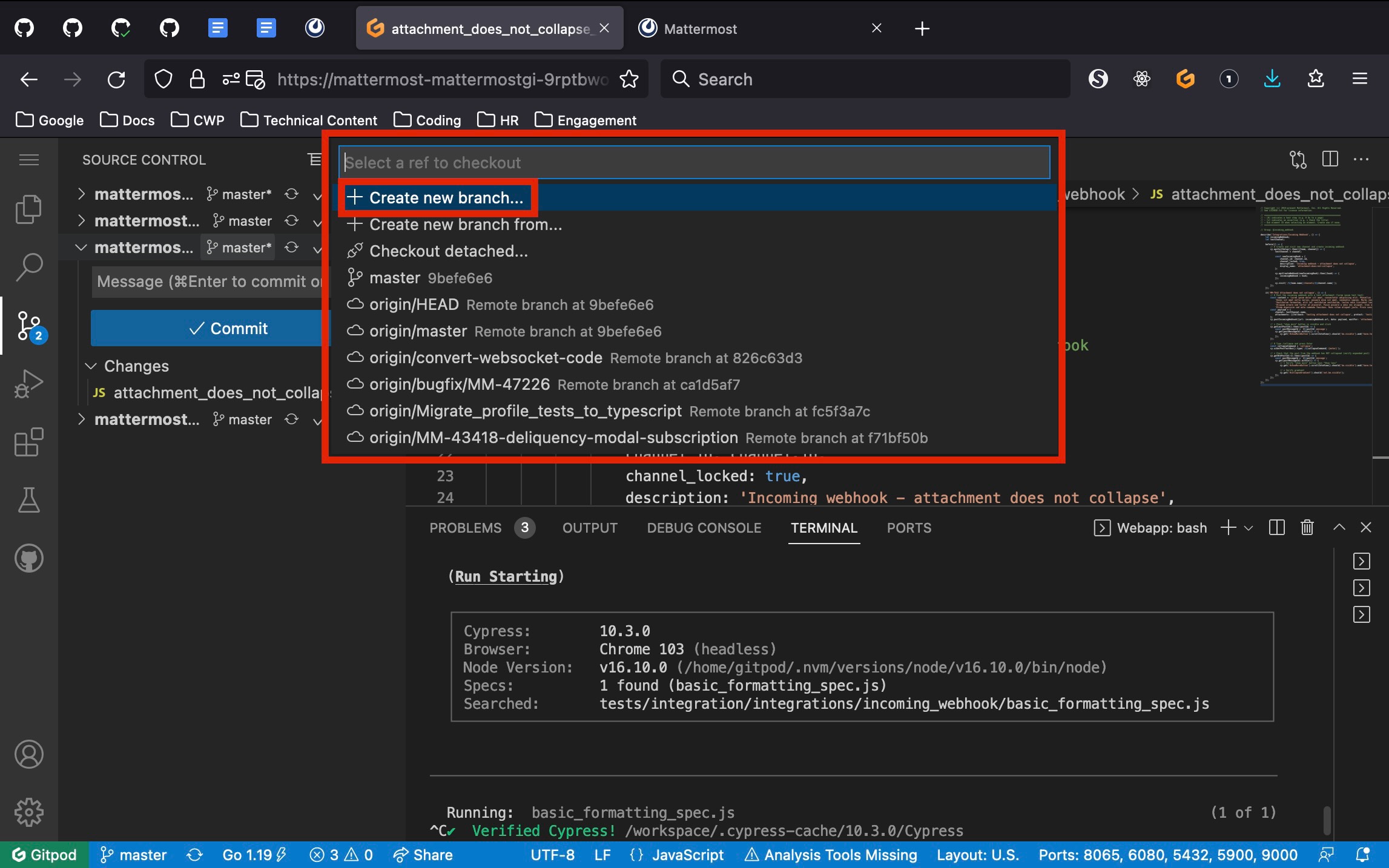

  2. Click the "Source Control" icon on the left sidebar. On the panel next to the side bar, you will see a list of the repositories in the workspace, and under each repository a list of the files that have changed (if any). Next to the label for mattermost-webapp, click the button with the branch name and the source control icon.
  3. A dropdown will appear via the command palette. Click the option that says: "+ Create new branch..." mattermost-gitpod-new-branch

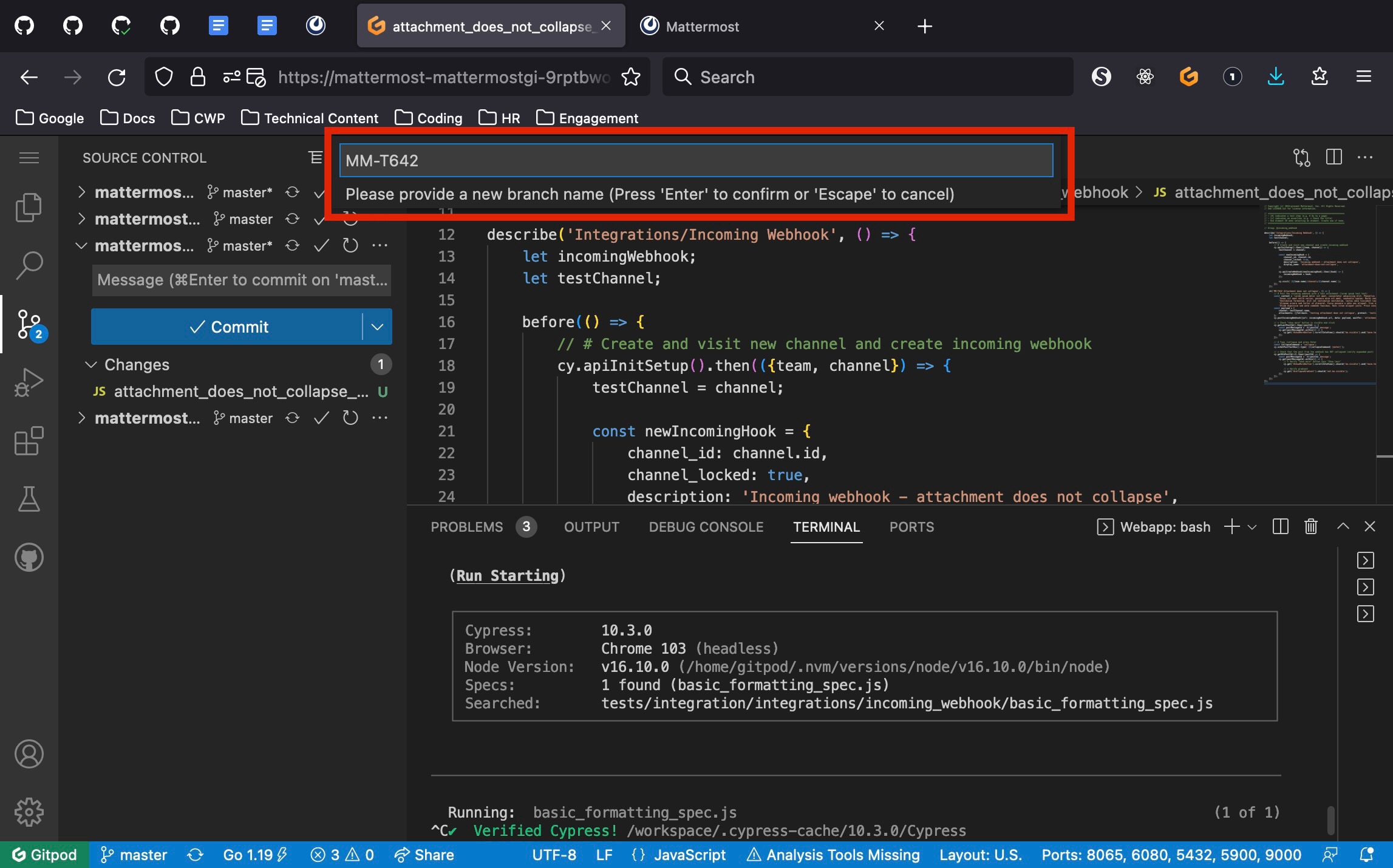

  4. In the box that appears, name your new branch. A good name idea is to name it after the code that refers to your issue - in this case, this is the "Test Key", so a suitable name for the branch is MM-T642. Then, hit Enter on your keyboard. mattermost-gitpod-branch-name

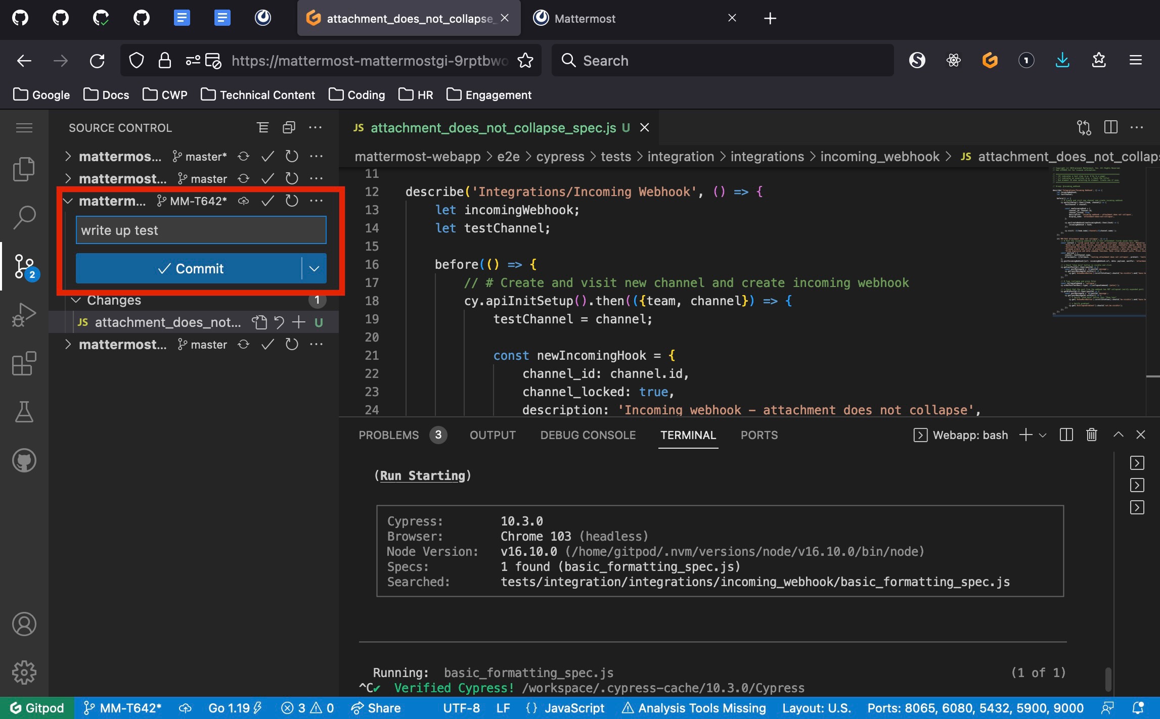

  5. Now that the branch has changed, you can commit your changes to it. Back in the source control panel, you can make a commit message in the text box above the "commit button" in the section for the mattermost-webapp repository. Then, press the "commit button". A modal may appear asking you to first stage your changes. mattermost-gitpod-commit-message

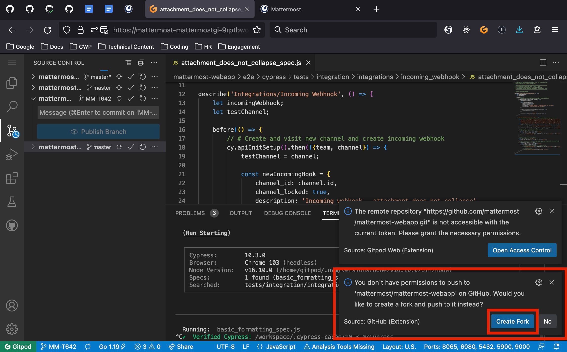

  6. You can now publish your branch to the remote. However, as you will not have access to the main repository itself, you will be prompted to first create a fork. Click on the "publish branch button" on the source control panel. A popup will appear, asking if you would like to make a fork and push to that instead. On the popup, select the "create fork" button. mattermost-gitpod-make-fork

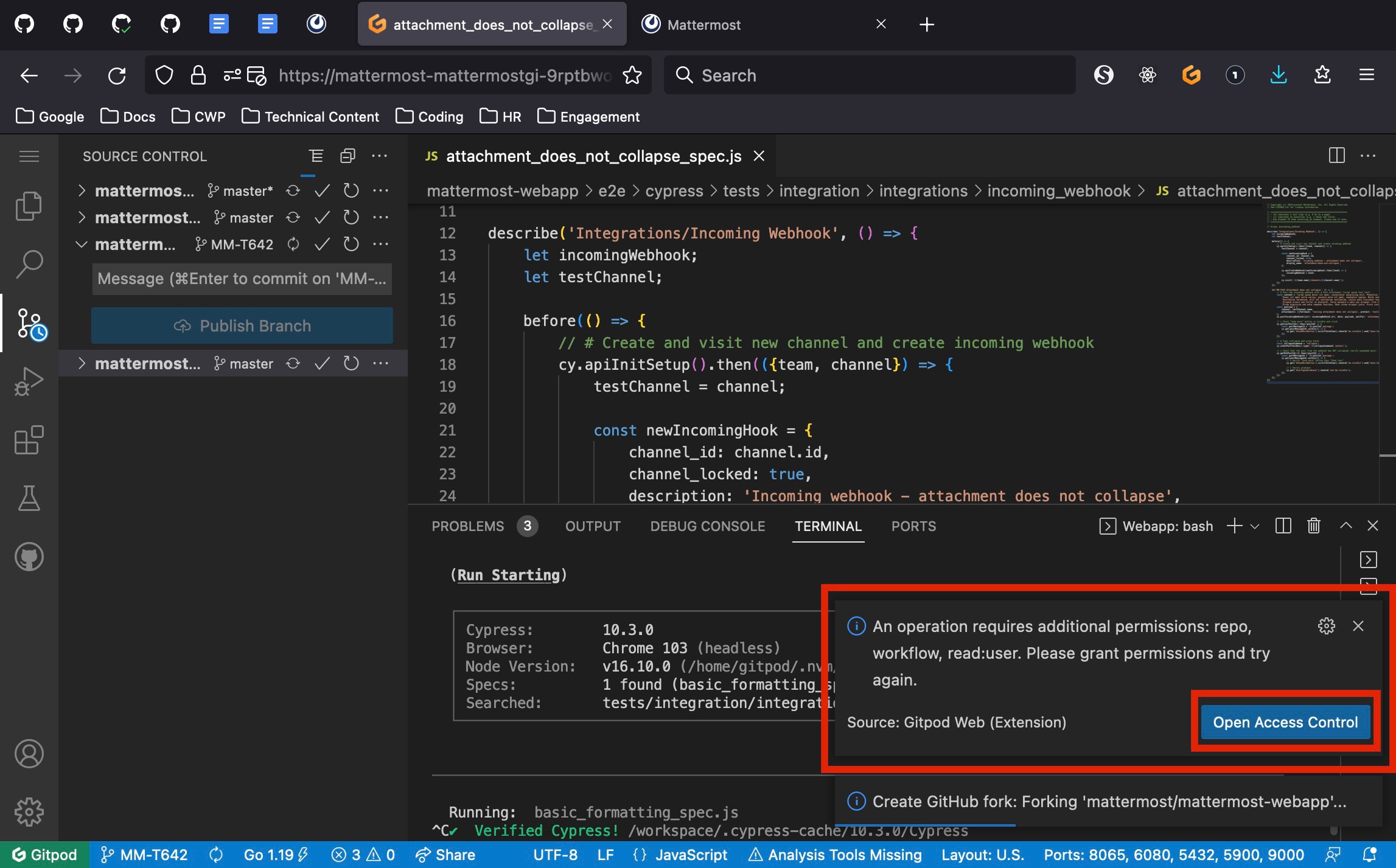

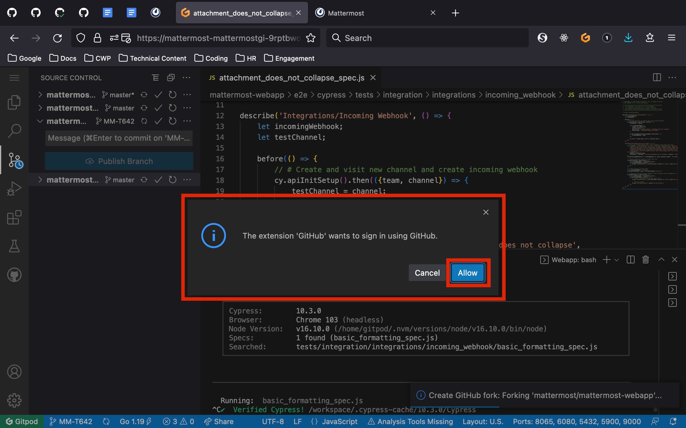

  7. During the process of fork creation, you may be prompted to grant GitHub access to Gitpod's GitHub extension (you should allow this). mattermost-gitpod-sign-into-GitHub
  8. You may also be asked to update the permissions you give Gitpod to access GitHub through a popup. If this happens, you will have to restart the fork creation process (publish branch -> say yes to creating a fork). Click the "open access control" button on the popup. mattermost-gitpod-need-perms

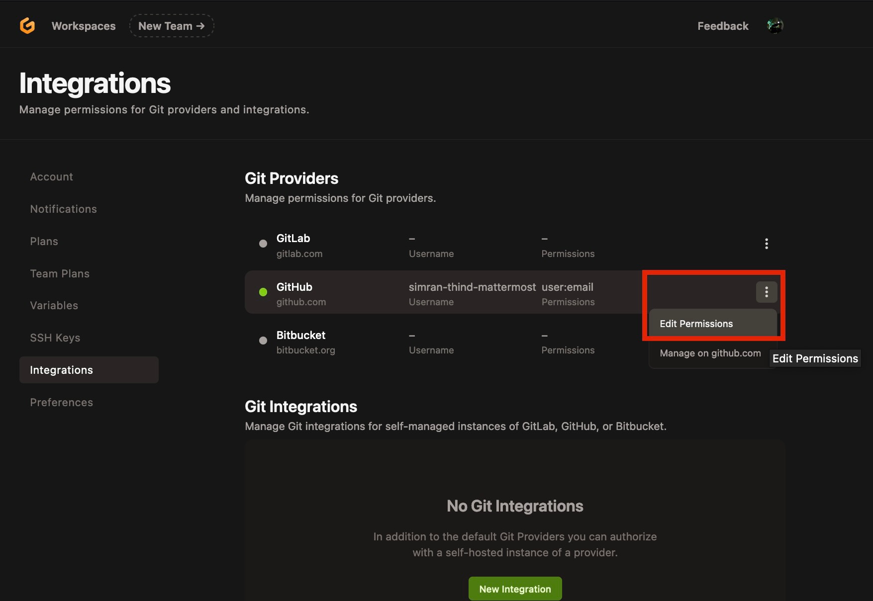

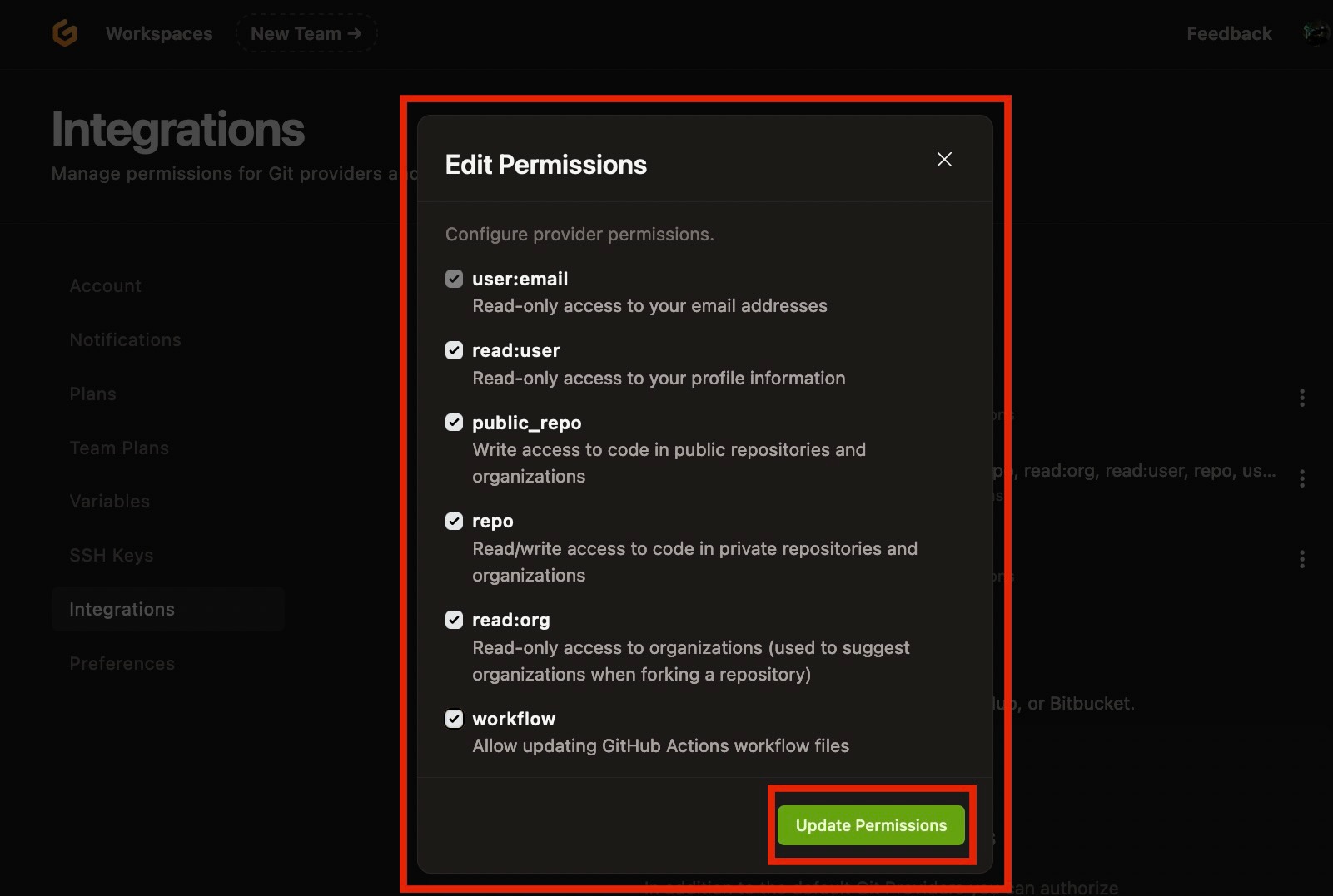

  9. You will get taken to the Integration section of Gitpod's settings. In the list of Git Providers on the page, find GitHub, click the three dots next to the listing, and select "Edit Permissions" from the dropdown menu. mattermost-gitpod-open-perms
  10. A popup will appear with a list of permission checkboxes. It's a good idea to check all of them off so you don't need to go through this process again. When you're done checking off the permissions, click the "Update Permissions" button. mattermost-gitpod-select-perms

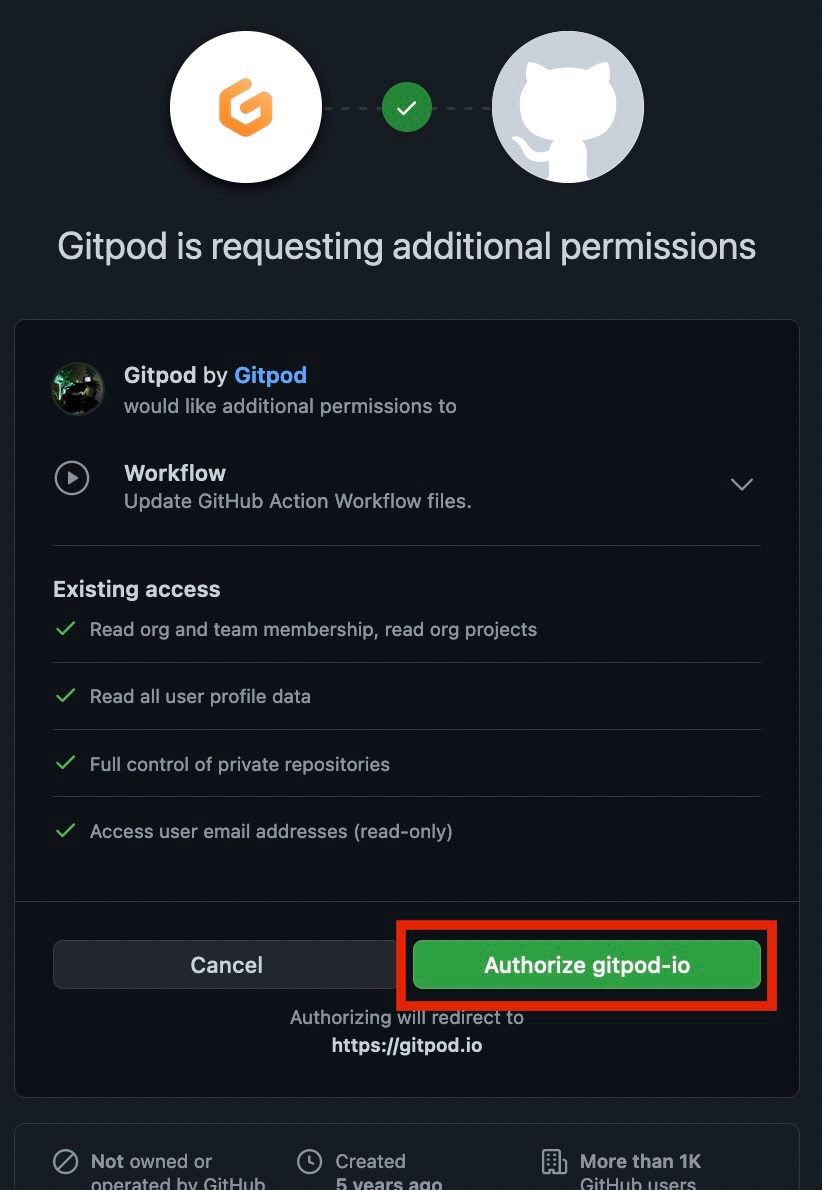

  11. Another tab might also appear where on GitHub's end you accept the additional permissions Gitpod is requesting. Click on the "authorize gitpod-io" button. mattermost-gitpod-confirm-perms

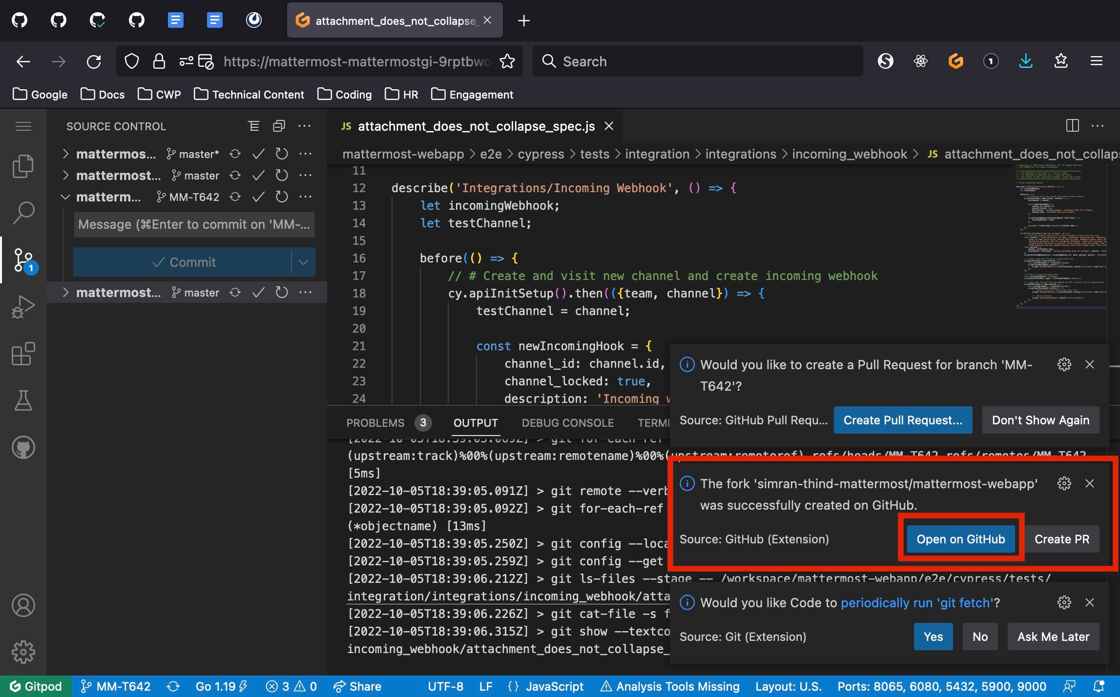

  12. Once the forking process is done, there will be a couple of popups that appear on Gitpod: one asking if you'd like to periodically run git fetch (which will periodically download content from the remote), another one asking if you'd like to create a pull request for the branch you're on right inside Gitpod/the VSCode editor, and finally one informing that the fork was successfully created. On the successful fork creation popup, click the open on GitHub option. mattermost-gitpod-open-fork-on-GitHub

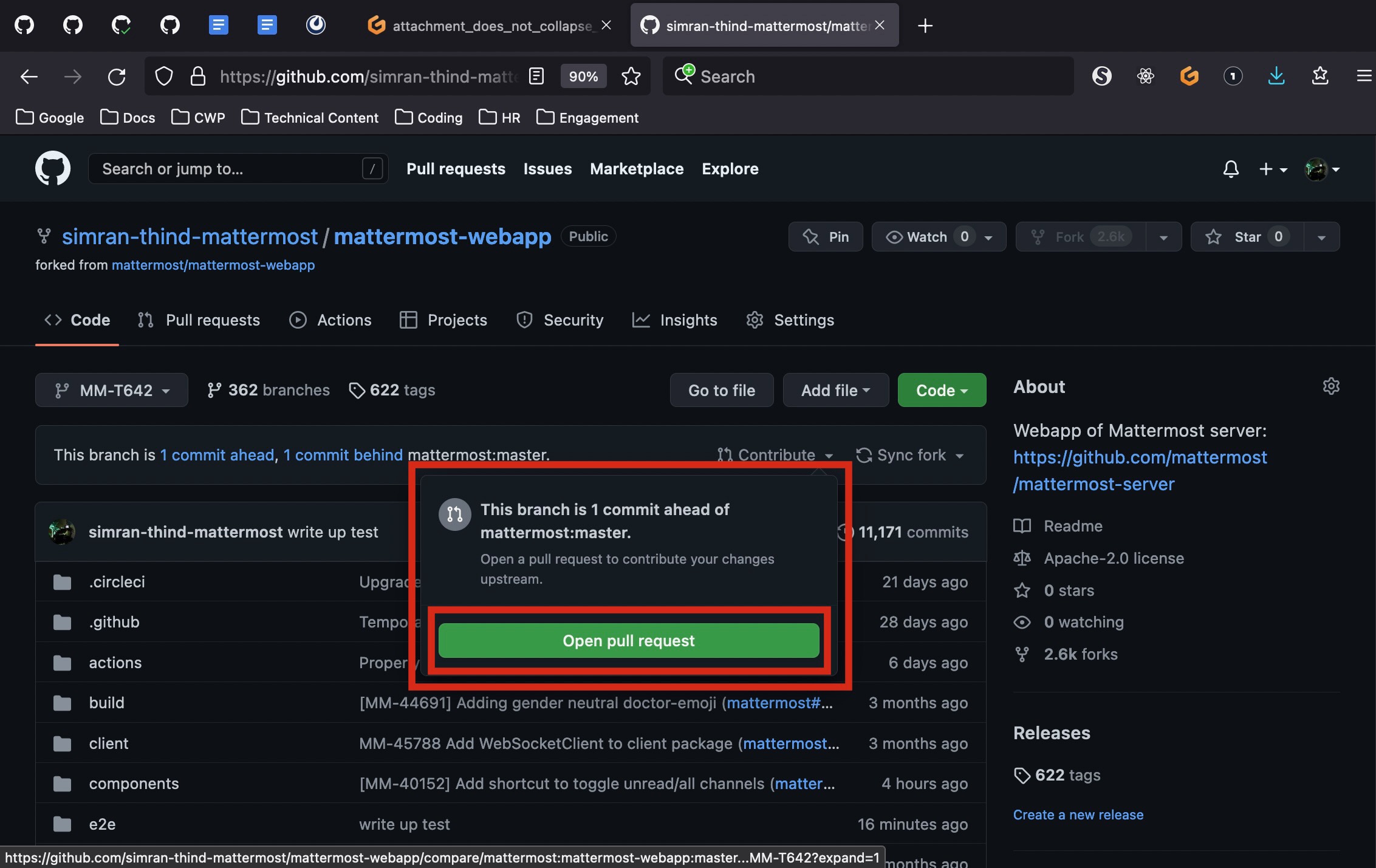

  1. You'll get taken to GitHub, to the fork of the repository you've worked on in your account instead of the main one in the Mattermost organization. Navigate to the branch you've made on your fork if you're not there already.
    • Near the top of the page will be a bar mentioning how many commits ahead/behind your branch is from the master/main branch of the main repository. There will also be two buttons: "contribute" and "sync fork". Click on the "contribute" button, and in the dropdown that appears, click the "open pull request" button. mattermost-gitpod-create-PR-on-GitHub

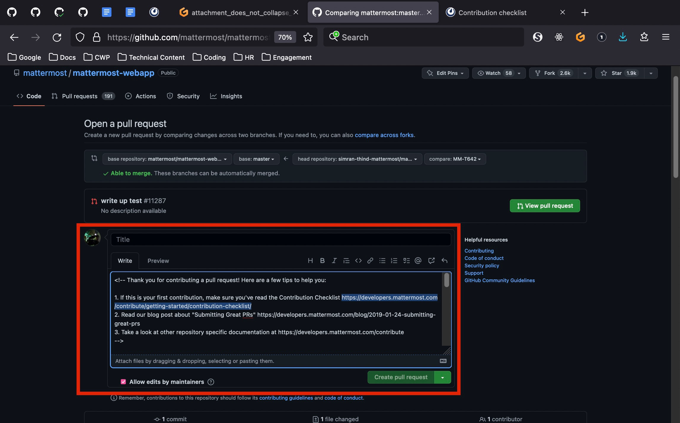

  2. You'll be taken to another page on GitHub called "Open a pull request". mattermost-gitpod-PR-creation-page
* The first section of the page compares whether the branches (your branch on your fork - the "head repository" vs. the master/main branch on the main repository - the "base repository") can be merged automatically.
* The second section of the page will show other PRs that are based on your same branch, if any.
* The third section is where you create a write-up for your pull request - giving it a title, and filling out the template. At the bottom of this section is a "Create pull request" button. This button will be faded out until you make a title for the PR.

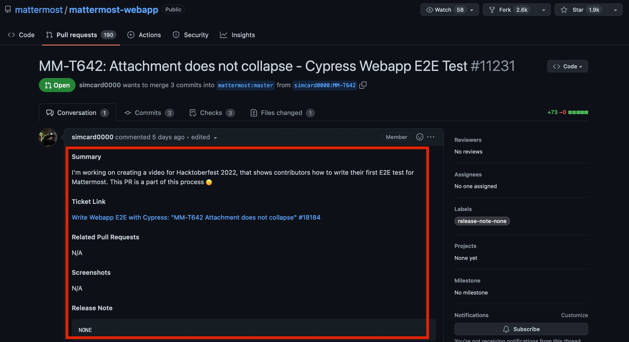

  1. Once you've created your pull request, you'll get taken to its page, like this one: MM-T642: Attachment does not collapse - Cypress Webapp E2E Test #11231. Below your initial body text of the PR will be a list of commits and other comments. At the end of this list is a checklist which notes the status of reviews required for the pull request, and the checks that the pull request must pass, plus a place to write your own additional comments. mattermost-gitpod-real-PR-1
