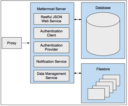

Mattermost supports the NGINX proxy
Mattermost architecture with NGINX proxy

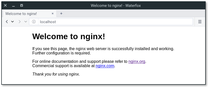

  1. After installing it, you already have everything you need. You can point your browser to your server IP address. You should see the default NGINX landing page:
Example of the default NGINX landing page.
If you see this page, you've successfully installed NGINX on your web server. This page is included with NGINX to show you that the server is running correctly.
Or you can also verify it by running curl http://localhost.
If NGINX is running, you see the following output:
