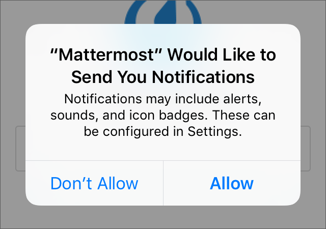

  2. (iOS) When the app asks whether you wish to receive notifications, confirm you want to receive notifications.
    Mattermost prompts you to confirm whether you want to allow mobile push notifications. To test mobile push notifications, you must select Allow.

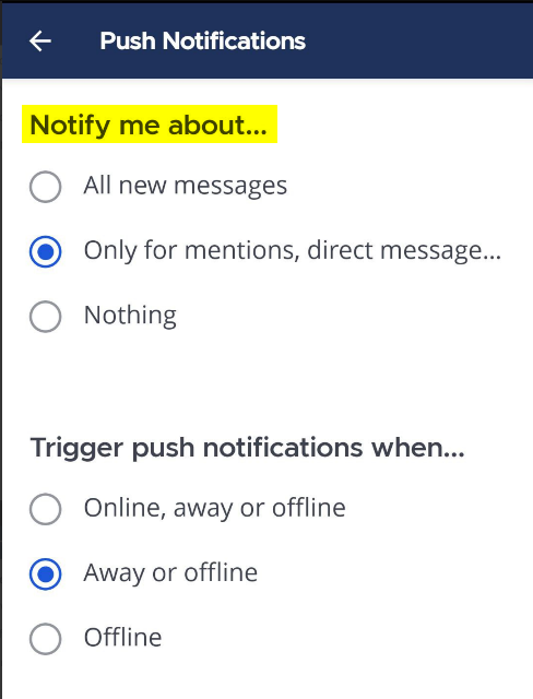

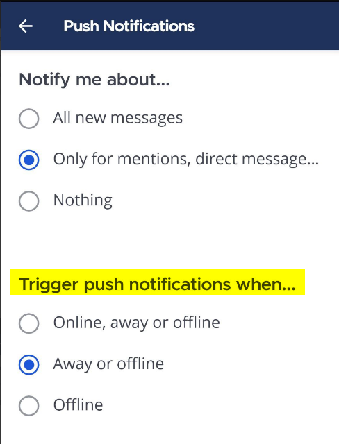

  3. Confirm push notifications are enabled for “Account A”.
    1. Go to the notification settings menu in the mobile app.
    2. Check that the mobile push notifications are set to send.
      Select Push Notifications to confirm when mobile push notifications will be sent. Specify whether all new messages or only mentions and direct messages send push notifications.
