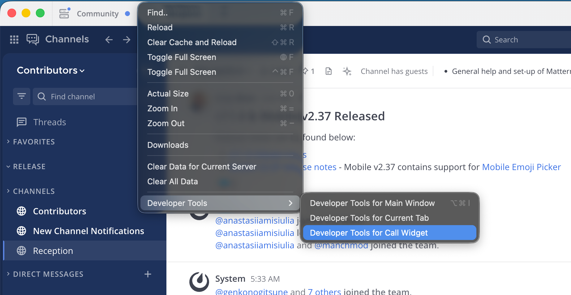

  • Desktop App: While a call is in progress, navigate to View > Developer Tools > Developer Tools for Call Widget. Next to the Filter field, select Verbose from the log level drop-down menu to view the debug output. To save the log, right-click within the console and select Save as....
