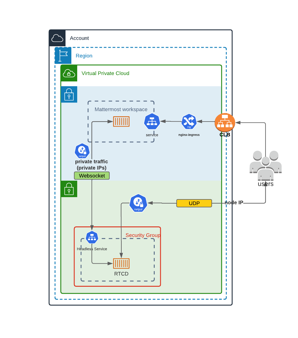

Architecture
This diagram shows how the RTCD standalone service can be deployed in a Kubernetes cluster. In this architecture:
- Calls traffic is handled by dedicated RTCD pods
- Scaling is managed through Kubernetes deployment configurations
- Call recording and transcription is handled by the calls-offloader service (see Calls Offloader Setup and Configuration)
If Mattermost isn't already deployed in your Kubernetes cluster and you want to use this deployment type, visit the Kubernetes operator guide.

Kubernetes-Specific Configuration
Network Configuration
For Kubernetes deployments, you need to ensure specific connectivity paths:
- Client to RTCD connectivity: UDP and TCP traffic on port 8443 is properly routed from clients to RTCD pods (for media, with TCP acting as a fallback).
- Mattermost to RTCD API connectivity: There needs to be a clear connectivity path between Mattermost and RTCD on the API port (TCP 8045)
- Network policies: Network policies must allow the required communications between Mattermost and RTCD services

Limitations
Due to the inherent complexities of hosting a WebRTC service, some limitations apply when deploying Calls in a Kubernetes environment.
One key requirement is that each rtcd process must live in a dedicated Kubernetes node. This is necessary to forward the data correctly while allowing for horizontal scaling. Data should generally direct directly to the pod running the rtcd process, as routing this traffic through a standard ingress is not recommended for RTCD deployments.
The general recommendation is to expose one external IP address per rtcd instance (Kubernetes node). This makes it simpler to scale as the application is able to detect its own external address (through STUN) and advertise it to clients to achieve connectivity with minimal configuration.
