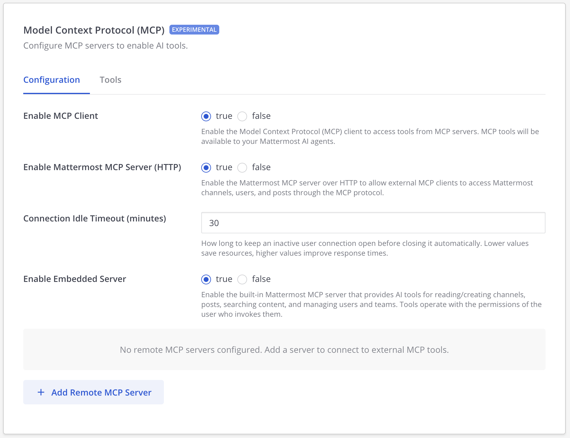

Model Context Protocol (MCP) Integration
The Model Context Protocol (MCP) integration allows Agents to connect to external tools and services through standardized MCP servers. This experimental feature enables expanding AI capabilities with custom integrations.
Configuration
  1. Navigate to System Console > Plugins > Agents > MCP Servers.
  2. Enable MCP integration by setting Enable MCP to True.
  3. Configure connection settings:
    • Idle Timeout: Set timeout in minutes for inactive client connections (default: 30 minutes)
Add MCP servers
  1. Select Add MCP Server to configure a new server.
  2. Configure server settings:
    • Server URL: The endpoint URL for your MCP server.
    • Custom Headers: Additional headers required by your MCP server (optional).
    • Server Name: Descriptive name for the server (auto-generated if not provided).
  3. Select Save to add the server.
Management
  • Connection Management: The system automatically manages user connections to MCP servers
  • Idle Cleanup: Inactive client connections are automatically closed after the configured timeout
  • Per-User Connections: Each user gets their own connection to MCP servers for security and isolation
