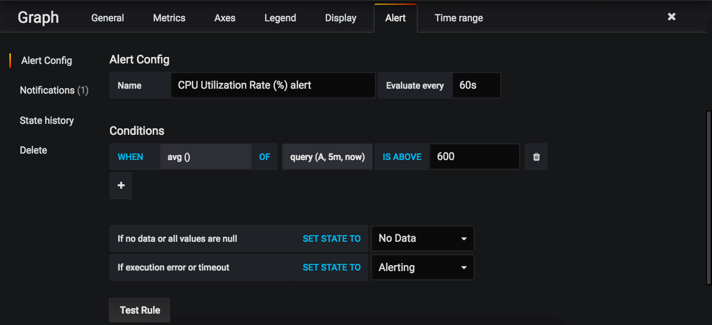

  1. Select the Alert tab:
Switch to the Alert tab to access and configure Grafana dashboard alerts for the current chart.

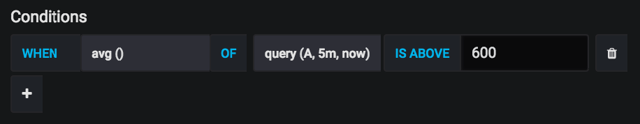

  1. The alert threshold, which will be discussed in the sections below, is the last field under Conditions (the one set to 600 in the screenshot above).
See the sections below for how to set the threshold for each individual chart. If you would like to add your own custom alert conditions, configure them here.
When configuring Grafana dashboard alerts, set custom threshold conditions in the Conditions section of the screen.

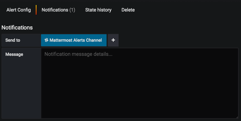

  1. To enable the notifications for any alerts, select the Notification tab on the left, then select Mattermost Alerts Channel under Send to:
When configuring Grafana dashboard alerts, set notifications for any alerts by switching to the Notification tab, selecting Send to, then selecting by Mattermost Alerts Channel.
Enter a message if you would like to add more context to the alert.

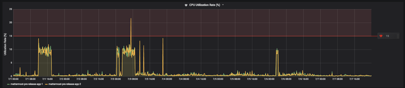

CPU Utilization Rate is fairly straightforward. CPU Utilization Rate tracks the CPU usage of the app servers as a percentage. The maximum percentage is based on the number of CPU cores or vCPUs your app server has. For example, if you have four CPU cores and your app server was at 100% utilization rate on all four cores, the graph would show 400% for that app server.
It’s best to set the alert threshold based on your average CPU utilization and how many cores/vCPUs your app servers have. Take a look at the chart over the last seven days. You’ll want to set the threshold somewhere between your maximum CPU usage (cores * 100) and the CPU usage you see. The lower you set the threshold, the more alerts, and therefore the more false positives, you will get. Set the threshold too high and you may not receive an alert for an incident until it’s gotten worse. The same principle applies to all alerts, regardless of the chart.
For example, on our community server, we have the threshold set to 15%:
Example CPU utilization rate metrics for the Mattermost Community Server, where the threshold is set to 15%. System admins should set the threshold between the maximum CPU usage and the CPU usage observed in metrics.
This value is below our maximum CPU usage and above our average usage at peak times. Therefore, we will get alerts if we begin experiencing unusually high CPU usage.

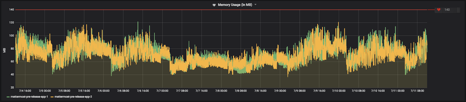

Memory Usage tracks the megabytes of RAM that your app servers are using. Set the threshold similar to the CPU Utilization Rate: below maximum available memory and above your average usage during peak times.
Here’s how we have the alert set on our Community server:
Example memory usage metrics for the Mattermost Community Server, where the threshold is configured similarly to the CPU utilization rate.

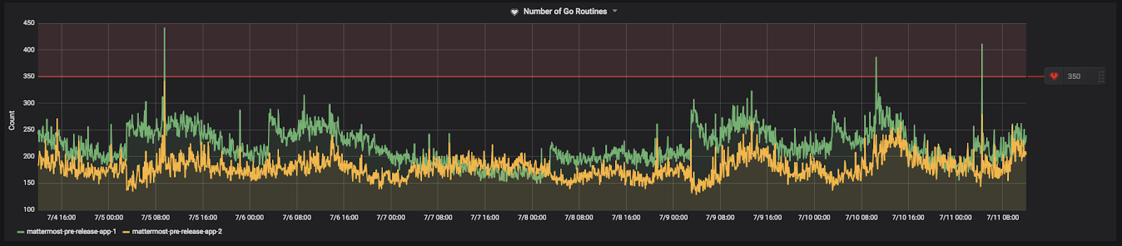

Number of Goroutines
Goroutines are functions or methods that run concurrently with other functions and methods. Goroutines are like lightweight threads with low-creation costs. A rising number of goroutines can be a good measure of the performance of your app servers. A continuous increase indicates your app server can't keep up and is creating goroutines faster than they can complete their tasks and stop.
Set the threshold somewhere above the average number of goroutines you see during peak load times. Small spikes are usually nothing to worry about. It’s the uncontrolled climbing of goroutines that you want to watch out for.
Here’s how we have it set on our Community server:
Example Goroutines metrics for the Mattermost Community Server, where the threshold is configured above the average number of Goroutines observed during peak load times.

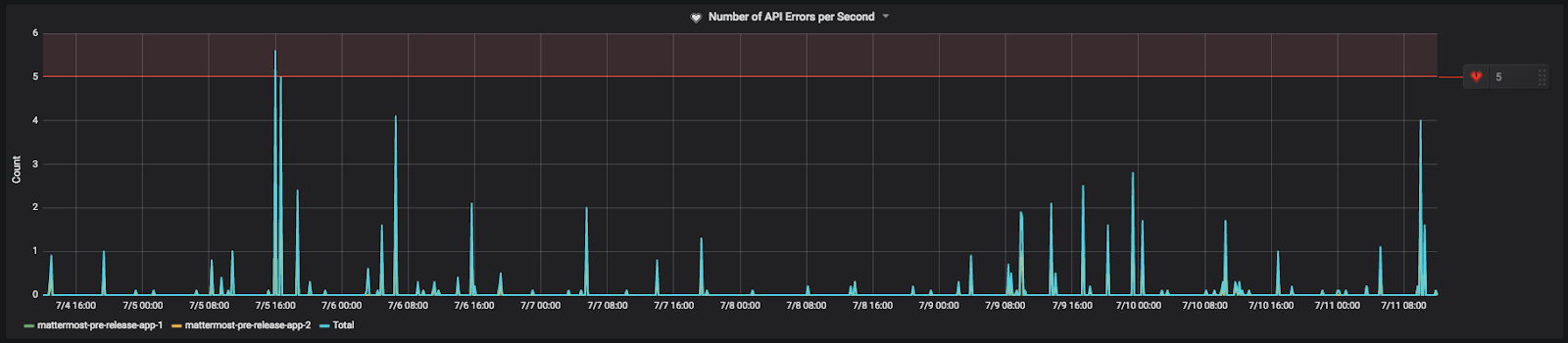

Any 4xx or 5xx HTTP response status codes are counted as a REST API error. API errors themselves are not necessarily a problem. There are many legitimate reasons for an API error to occur, such as users’ sessions expiring or clients requesting to see if a resource exists and is being given a 404 Not Found response. It is normal to have some API errors that scale with your installation base.
That said, errors against the REST API can be indicative of deployment and other issues. For example, if one of your app servers did not deploy correctly for whatever reason, it may begin returning a high number of API errors. Another example would be a rogue bot spamming the API with bad requests. Alerts on API errors per second would help catch these and other issues.
Here’s how it’s set on our Community server:
Example metrics of the number of API errors per second for the Mattermost Community Server, where it's normal to have some API errors that scale with an installation base, but that can be indicative of deployment issues or other issues.

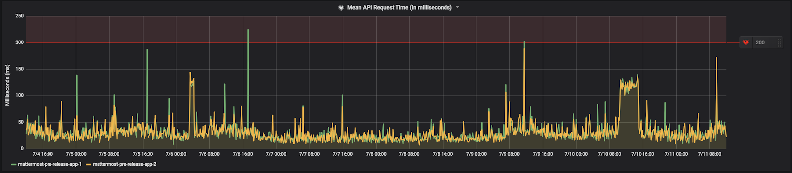

The Mean API Request Time is the average amount of time a REST API request to the Mattermost app server takes to complete. If an app server starts to perform poorly, you’ll likely see a rise in the mean request time as it takes longer to complete requests. This could also happen if your database can’t sustain the load from the app servers. It may also be indicative of an issue between the app servers and your proxy.
You’ll want to set the alert threshold a little above what the mean request time is during your peak load times.
Here’s how it’s set on our community server:
Example mean API request time metrics for the Mattermost Community Server, where the alert threshold is configured a bit above the mean request time during peak load times.
