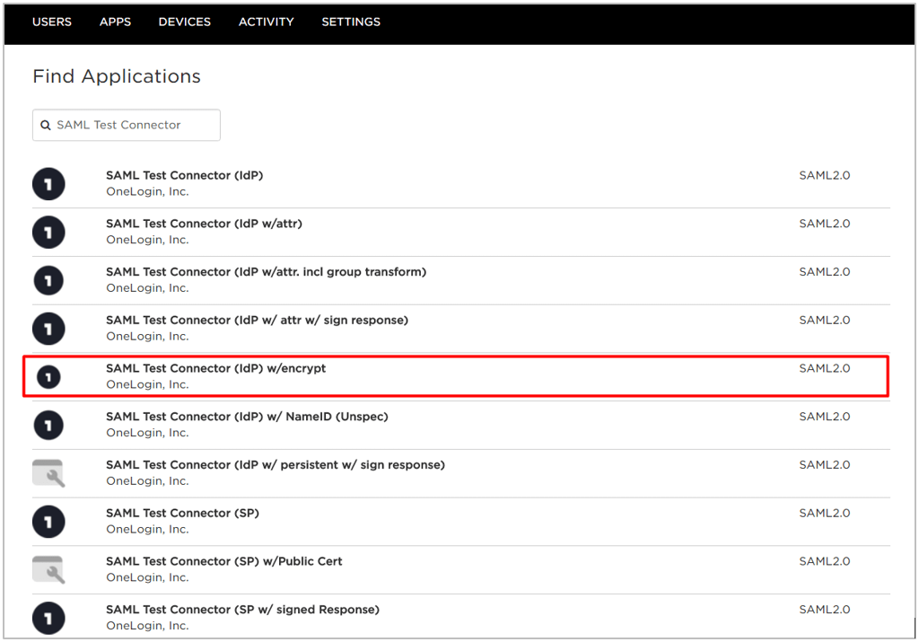

  1. Add a SAML test connector app.
  1. Log in to OneLogin as an administrator.
  2. Go to Apps > Add Apps.
  3. Search for "SAML Test Connector", then select SAML Test Connector (Advanced).
In OneLogin, go to Apps > Add Apps, search for SAML Test Connector, then select the matching result in the list

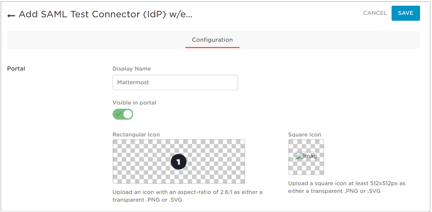

  1. In the Display Name field, enter a name for the application, then optionally upload an app icon. You can use the Mattermost logo for the icon, which you can download from Branding Guidelines page.
Enter a display name for the application in the Display Name field. You can optionally upload an app icon. Ensure the Visible in portal option is enabled, and save your OneLogin changes.
  1. Make sure that the Visible in portal option is enabled.
  2. Select Save.

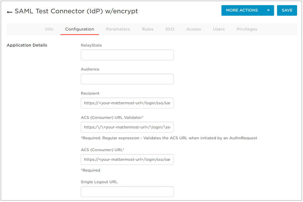

  1. Configure the app.
  1. Select the Configuration tab, then enter the following values:
  • RelayState: leave blank
  • Audience: leave blank
  • Recipient: https://<your-mattermost-url>/login/sso/saml where https://<your-mattermost-url> should typically match the Mattermost Site URL.
  • ACS (Consumer) URL Validator: https:\/\/<your-mattermost-url>\/login\/sso\/saml
  • ACS (Consumer) URL: https://<your-mattermost-url>/login/sso/saml
In OneLogin, select the Configuration tab to configure the SSO integration with required values.

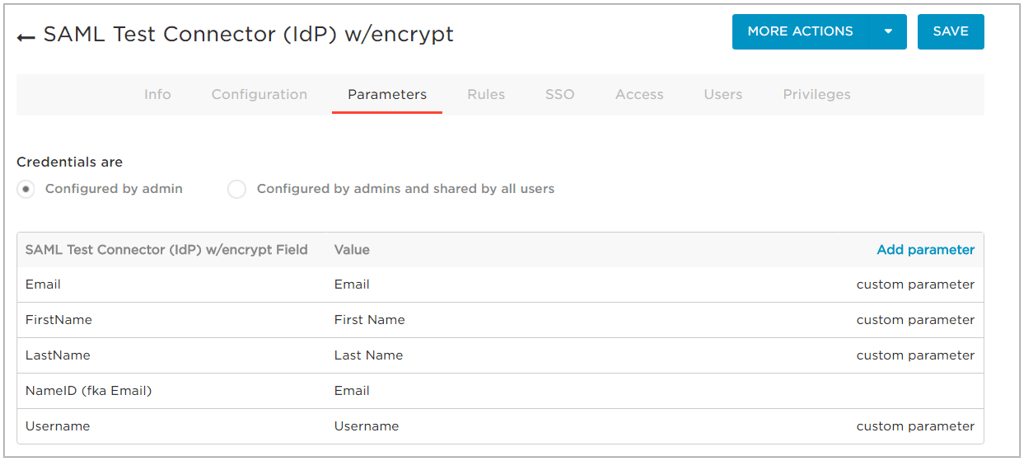

  1. Enter the attribute parameters. The following attributes are recommended:
NameValue
IDUUID
EmailEmail
FirstNameFirst Name
LastNameLast Name
Name ID valueEmail
UsernameUsername
Attribute parameters map attributes between OneLogin and Mattermost. For more information on which attributes are configurable, see our documentation on SAML configuration settings.
Email attributes are required.

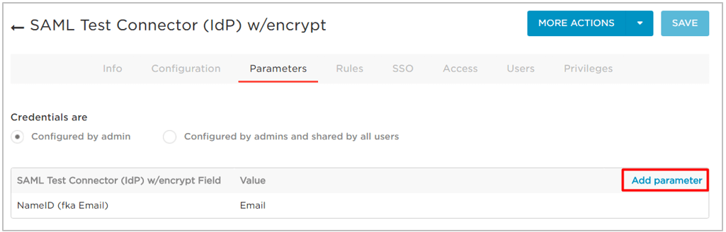

  1. Select the Parameters tab.
  2. Select Add Parameter.
In OneLogin, select the Parameters tab, then select Add parameter. Map attribute parameters between OneLogin and Mattermost. Email attributes are required.
  1. In the Field name field, enter an attribute parameter such as Email.
  2. Select the Include in SAML assertion checkbox.
  3. Select Save.
For each field you map in OneLogin, ensure the Include in SAML assertion flag is enabled.
  1. Select Edit.
  2. In the Value field, select the OneLogin value that corresponds to the attribute parameter.
For each field you map in OneLogin, select the OneLogin value that corresponds to the attribute parameter.
  1. Repeat the steps above to add any other attributes that you need. After you've added all the attributes you want to use, the parameter list should look similar to the following image:
Example of attribute parameters mapped between OneLogin and Mattermost.

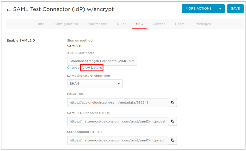

  1. Copy the SSO information.
  1. Select the SSO tab.
  2. Copy the values in the Issuer URL and SAML 2.0 Endpoint (HTTP) fields, then save them for later use.
In OneLogin, select the SSO tab, copy the Issuer URL and SAML 2.0 Endpoint (HTTP) values to a convenient location.

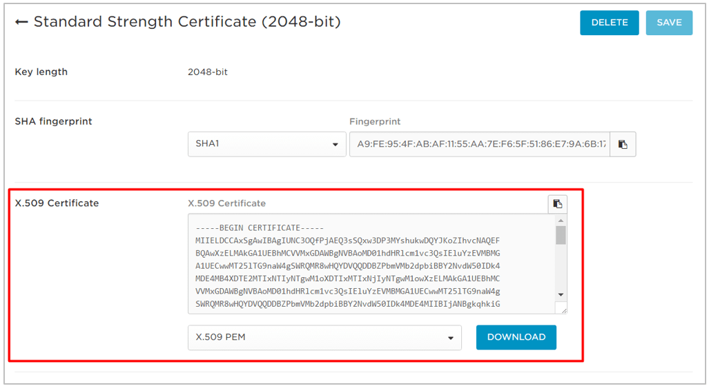

  1. Select View Details to view the X.509 certificate.
  2. Make sure that the X.509 PEM option is selected in the drop-down.
On the SSO tab in OneLogin, select View Details to access the X.509 certificate. Ensure that the X.509 PEM option is selected. Select Download and save the file in a convenient location.
  1. Select DOWNLOAD, then save the file in a convenient location for later use.

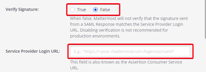

  1. Configure Mattermost to verify the signature.
  1. In the Verify Signature field, select True.
  2. In the Service Provider Login URL, enter https://<your-mattermost-url>/login/sso/saml.
On the System Console SAML page, enable the Verify Signature option by setting it to true, then enter your specific Service Provider Login URL based on your Mattermost URL

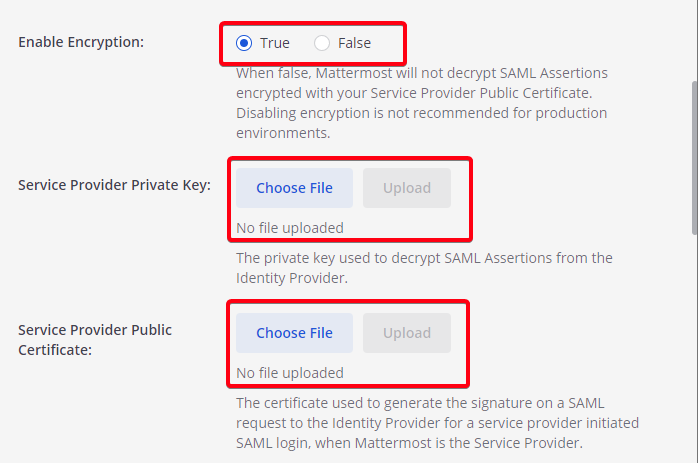

  1. Configure Mattermost to sign SAML requests using the Service Provider Private Key.
  2. Enable encryption.
  1. In the Enable Encryption field, select True.
  2. In the Service Provider Private Key field, upload the private key that you generated earlier.
  3. In the Service Provider Public Certificate field, upload the public key that you generated earlier.
On the System Console SAML page, enable encryption, then upload both the private and public generated keys.

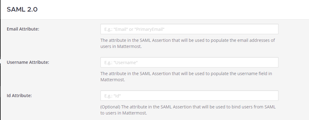

  1. Set attributes for the SAML Assertions, which are used for updating user information in Mattermost.
The Email Atttribute field and the Username Attribute field are required, and should match the values that you entered earlier when you configured the SAML Test Connector on OneLogin.
On the System Console SAML page, set attributes for the SAML Assertions used to update user information in Mattermost. Both Email Attribute and Username Attribute are required, and should match the values entered when configuring the SAML Test Connector in OneLogin.
