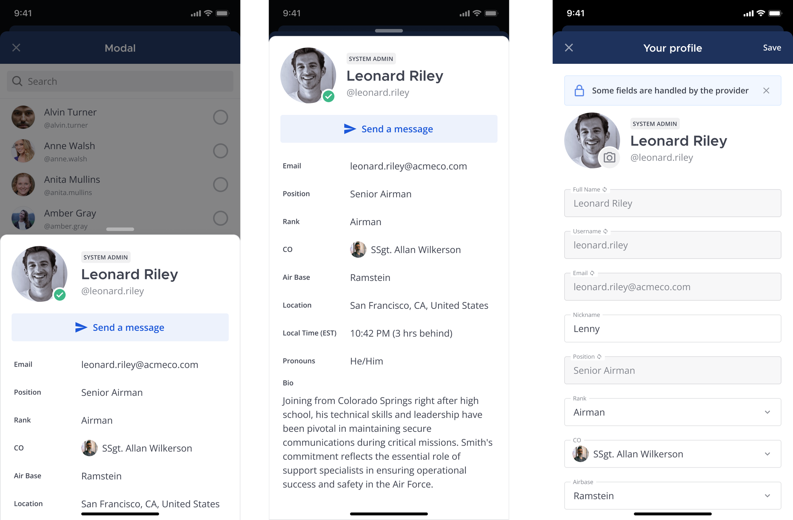

Mobile examples of a user profile with user attributes added as system attributes.

Additionally, from mobile app v2.31.0, user attributes are fully supported on mobile devices. Mobile users can both view and manage profile attributes (if allowed by admin settings) directly from the mobile app. Mobile attribute support requires the same server-side configuration, and no additional mobile-specific setup is required.
